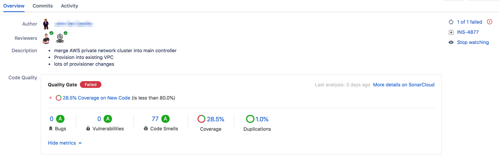

3. BitBucket
At this point, we have Jenkins automatically testing PRs and SonarCloud providing analysis.  To make it as easy as possible for approvers to see that information, we just need to enable the SonarCloud widget in our Bitbucket repository.
Enable SonarCloud widget in Bitbucket.
Now, whenever a PR is created, the widget will pull in test coverage, bugs and code smell metrics.  Using the Bitbucket Jenkins plugin also means that our PRs will show a handy “build passed” status to let us know when a branch has is successfully passing all test cases.
