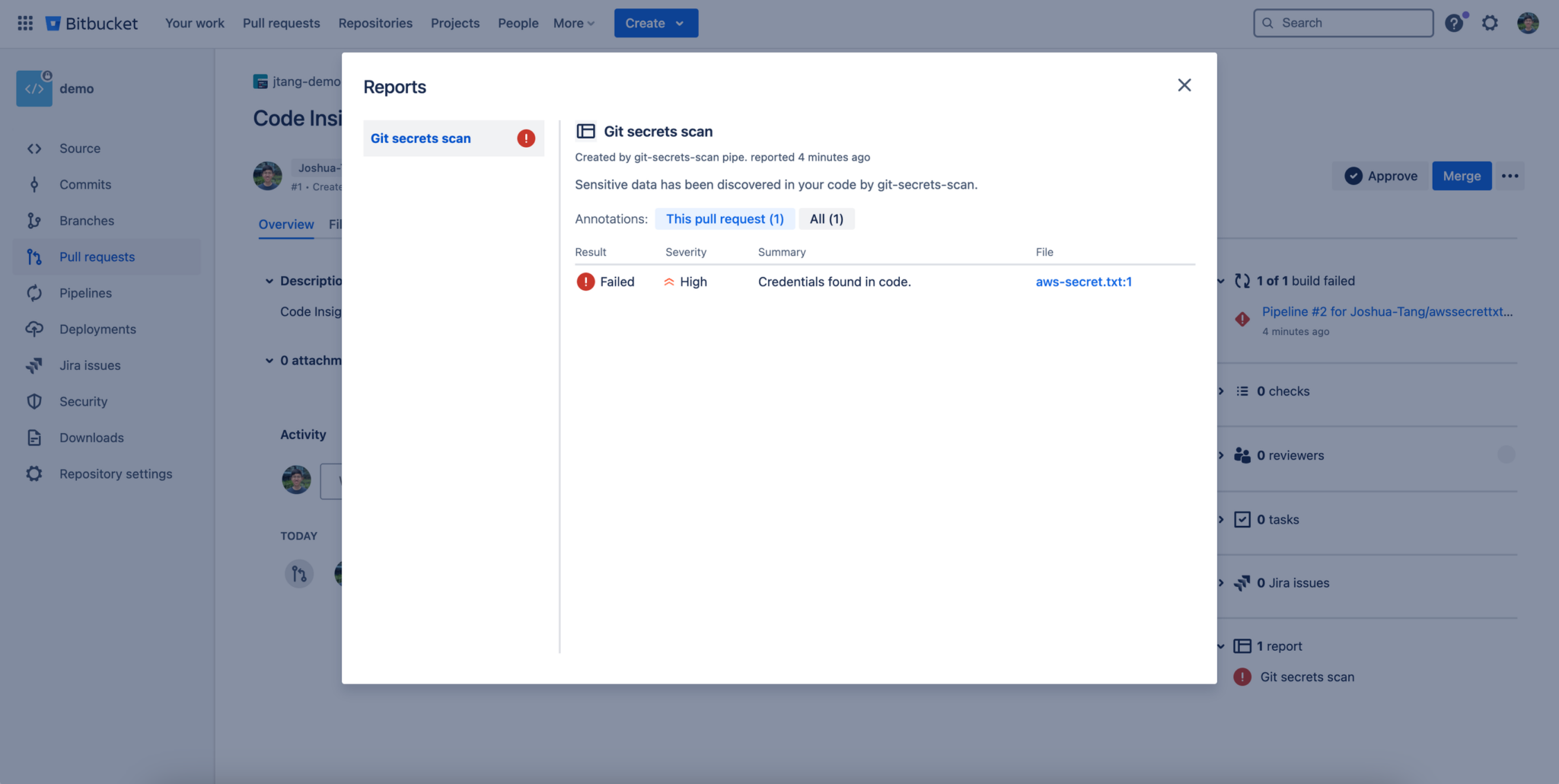

The code insights functionality in Bitbucket Cloud provides a variety of reports, annotations, and metrics to help your team have full context during the code review process.
With code insights, you can automatically have artifacts such as static analysis reports, security scan results, artifact links, unit test results, and build status updates appear in your pull request screen so reviewers have access to all reports and statuses before they approve the code change.
These artifacts appear in the reports widget in the UI and can be expanded to a modal that shows report details.

Code insights consist of two main components – reports and annotations. Reports are the artifact that shows any information you want to share. Annotations are individual findings that have been identified as part of a report, such as a line of code indicating a vulnerability. These annotations can be attached to a specific file and even a specific line within that file.
