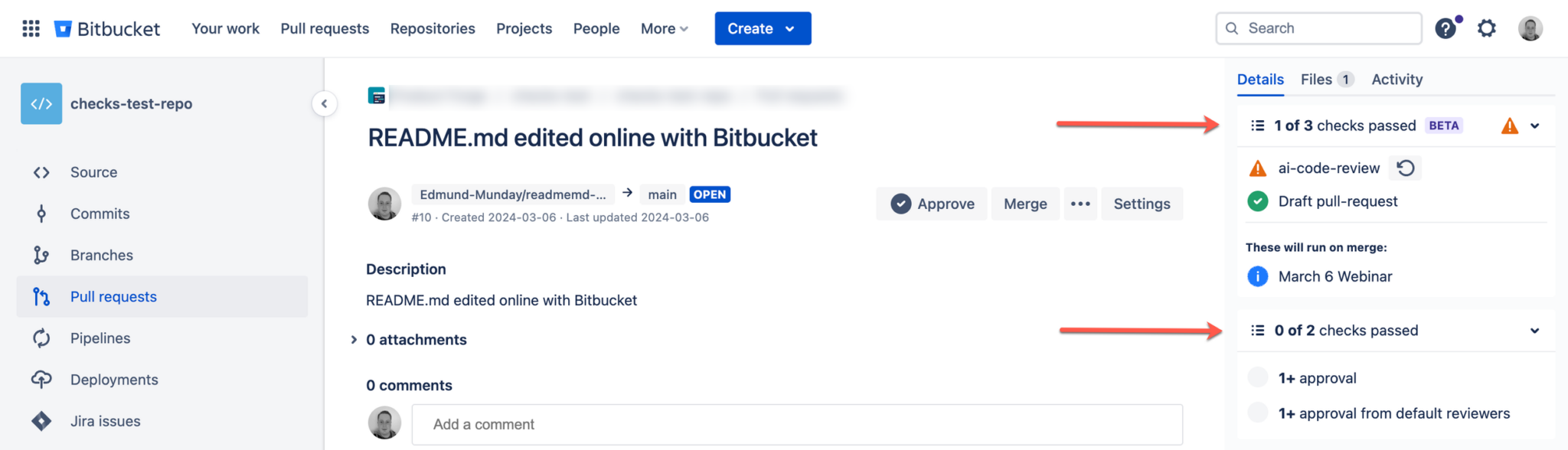

Consolidating checks on pull requests
We’re standardizing the workflow for enforcing and addressing both custom and classic merge checks on pull requests. Previously, they appeared in separate UI cards with slightly different behaviours.
With custom merge checks’ GA release, these cards will be consolidated into one. Classic checks’ behaviour will be standardized to match the updated UX introduced during the custom merge checks beta.

For pull request reviewers, on-merge
checks will be clearly separated from traditional pre-merge
checks in the pull request sidebar and merge workflow.
