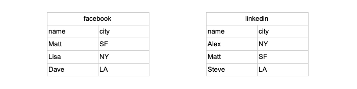

The way both of these clauses can be used to help join data is through defining the condition on which the two tables are joined. To demonstrate this, lets use an example data set of facebook friends and linkedin connections.
![facebook vs linkedin](https://wac-cdn.atlassian.com/dam/jcr:22808ccc-1d69-4a86-897b-736ef80708b7/fbAndLinkedin.png?cdnVersion=2022)
We want to see the people who are both our friend and our connection. So in this case it would only be Matt. Lets now query using a variety of defining the JOIN condition.

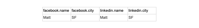

![names and city](https://wac-cdn.atlassian.com/dam/jcr:1401d98b-3a11-4068-9b7e-7afd09211e17/namesAndCities.png?cdnVersion=2022)
The first two are types of explicit joins and the last is an implicit join. An explicit JOIN explicitly tells you how to JOIN the data by specifying the type of JOIN and the join condition in the ON clause. An Implicit JOIN does not specify the JOIN type and use the WHERE clause to define the join condition.

![](https://wac-cdn.atlassian.com/dam/jcr:1401d98b-3a11-4068-9b7e-7afd09211e17/namesAndCities.png?cdnVersion=2022)
The first query is clear, each clause has its own purpose. The second query is more difficult to understand because the ON clause is being used to both JOIN the data and filter it.

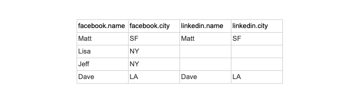

In a LEFT JOIN it brings in every row from the first table “facebook” and joins wherever the join condition is true (facebook.name = linkedin.name) this would be true for both Matt and Dave. So the interim table would have been.
![filtering](https://wac-cdn.atlassian.com/dam/jcr:0d3590f8-1894-466c-8b34-90f012c871fd/filtering.png?cdnVersion=2022)
Then the WHERE clause filters these result to rows where facebook.city = ‘SF’, leaving the one row.

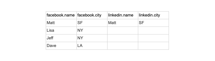

![](https://wac-cdn.atlassian.com/dam/jcr:69df7633-6f98-4189-90d1-e36cba6b9544/moreFiltering.png?cdnVersion=2022)
The join condition is different in this query. The LEFT JOIN brings in every row and the data that is JOINed in from linkedin only happens when facebook.name = linkedin.name AND facebook.city = ‘SF’. It does not filter out all of the rows that didn’t have facebook.city = ‘SF’
