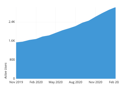

What is an area chart?
An area chart combines the line chart and bar chart to show how one or more groups’ numeric values change over the progression of a second variable, typically that of time. An area chart is distinguished from a line chart by the addition of shading between lines and a baseline, like in a bar chart.

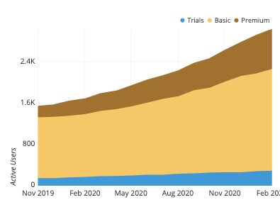

This area chart shows the number of active users for a fictional web-based company, computed by month. Values for each month can be measured not just from the vertical position of the top of the shape, but also the colored height between the baseline and top. In this chart, we can see that the number of active users has about doubled from November 2019 to February 2020, and that the rate of user gains has increased over time.

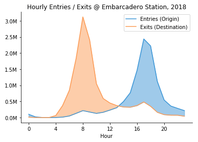

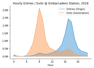

Overlapping area chart
In the case that we want to compare the values between groups, we end up with an overlapping area chart. In an overlapping area chart, we start with a standard line chart. For each group, one point is plotted at each horizontal value with height indicating the group’s value on the vertical axis variable; a line connects all of a group’s points from left to right. The area chart adds shading between each line to a zero baseline. Since the shading for groups will usually overlap to some extent, some transparency is included in the shading so that all groups’ lines can be easily seen. The shading helps to emphasize which group has the largest value based on which group’s pure color is visible.
Be careful that one series is not always higher than the other, or the plot may become confused with the other type of area chart: the stacked area chart. In those cases, just keeping to the standard line chart will be a better choice.

Most of the active users come from basic accounts, but premium users seem to be growing proportionally faster.

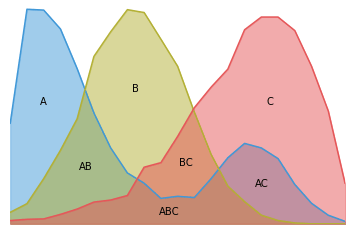

The more series we have in an overlapping are chart, the more combinations of colors there will be when they overlap. The fact that most colors will not be associated with a single group can cause some difficulty in interpretation. Even with only three series, this can sometimes be too much to track: three individual colors, three pairwise overlaps, and one color for all three groups overlapping totals seven colors in all.
Comparing two series is usually safe, though if one series is always larger than the other, the plot can be easily mistaken for a stacked area plot instead. Readers can also be confused by interpreting the overlapping colors, which will not be present in the general legend. As a general rule of thumb, if you’re thinking about using an overlapping area chart, limit yourself to two series and think about if using a line chart will show the comparison between groups more clearly.

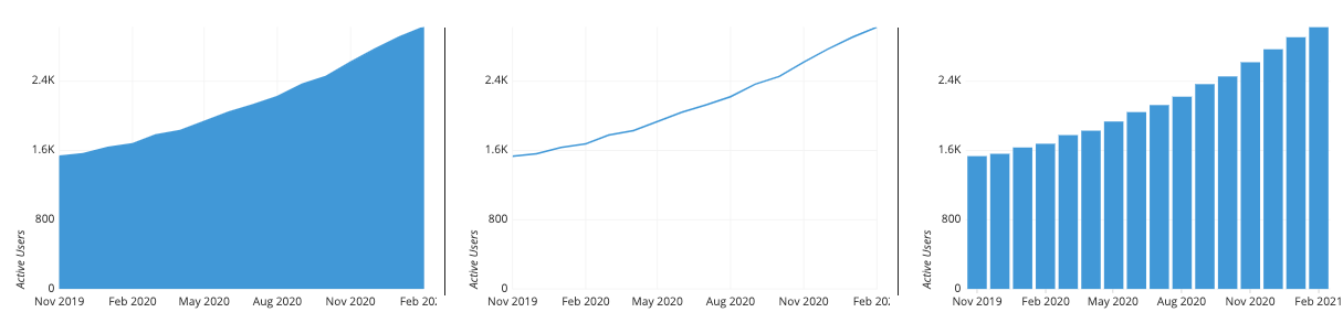

As noted near the start of the article, the typical use case for the area plot is to make a comparison or to show a division of quantities between two or more series. When we just have a single series of values to plot, it is often the wrong choice to use an area chart. The better option is to choose just a bar chart or line chart, depending on what you want to learn or communicate about the data.
If we want to understand the progression of exact values over time and we don’t have too many values to plot across the horizontal axis, then a bar chart is a good choice. Otherwise, a line chart is a better choice. Lines have a more efficient data-to-ink ratio and cleaner look with a lot of values to plot compared to bars. In addition, when we have a lot of values, we’re likely to be more interested in the direction and slope of trends rather than exact values, a case where line charts perform better.

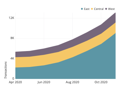

In a stacked area chart, gauging exact values is only really easy for two cases: for the overall total and for the bottommost group. For intermediate groups, getting the exact value of a group’s contribution requires finding the height of that group’s line, and subtracting the height of the line below it.
The task becomes even worse when we want to track changes over time. As before, this is easy for the total and bottommost group. However, intermediate groups are hampered by a changing baseline, making it difficult to perceive exact vertical differences. The below example adapted from this blog post makes this clear. While the central yellow group’s magnitude appears to change over time, in fact, the heights at each point are consistent.

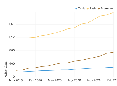

If you want to know about the exact group values and their changes over time, then choosing a standard line chart will be a better option, as demonstrated in this Everyday Analytics article.

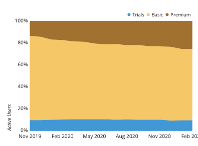

Percentage stacked area chart
A common option for area charts is the percentage, or relative frequency, stacked area chart. Rather than stack the absolute values of each group at each vertical slice, we stack the relative or percentage contribution of each group to the total, so that the overall height is always 100%. This chart type loses information about the trend of the absolute totals (and so will need its own line chart) but helps to bring out the comparison of relative contributions between groups. As a bonus, this chart type gains a second baseline across the top of the plot upon which an individual group’s contributions can be gauged.

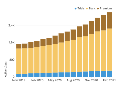

The stacked bar chart is very similar to the stacked area chart, just with bars instead of lines. Thus, many of the limitations of the stacked area chart also apply to the stacked bar chart. However, one advantage of stacked bars is that it is much easier to make a consistent judgment of value within each horizontal-axis bin. The shaded regions in an area chart can become distorted as seen above, especially when a line changes direction. Since each region is rectangular in a stacked bar chart, this kind of distortion is avoided.

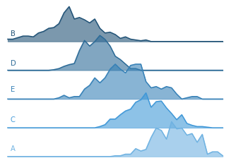

One additional alternative to the overlapping area chart is the ridgeline plot. Rather than plot all lines and colored regions on the same axis, the ridgeline plot puts each line on a different axis, each one with a partial vertical offset from the others. Due to the offset nature of lines, vertical markings are usually left out of a ridgeline plot. This means that ridgeline plots are at their most useful when there is a clear pattern in the individual series’ values based on their shapes alone.

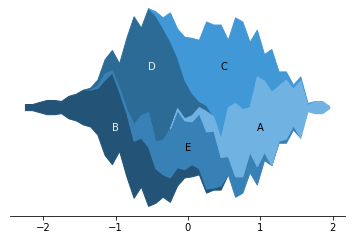

A fanciful relative of the area chart is the stream graph. In a stacked area chart, all of the lines are stacked on top of each other over a straight baseline at the bottom of the stack. With a stream graph, the baseline is set through the center of the chart, and the areas symmetrically gathered around the central line. Because of this, it is difficult to gauge precise values for any group or even the overall total.
As argued by Andy Kirk, stream graphs are best used in an interactive form when lots of data is to be presented to a wide audience. Interactivity is vital to allow readers to dig into the visualization and form their own findings. However, when accurate judgments need to be made or a static presentation needs to be made, it’s better to stick to a more conventional visualization, aggregating the data in a way that best draws out the points you wish to present.
This plot uses the same data as the ridgeline plot above.
