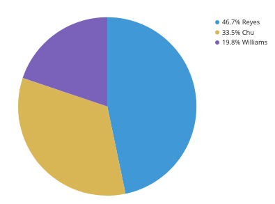

Basic pie chart: vote distribution by candidate
The pie chart above depicts the distribution of votes for a fictional election for a small city. We can see that Reyes, represented by the first blue slice, has just less than half of the votes. Chu (yellow) is in second, with about a third of the votes, while Williams (purple) is last, with about a fifth of the votes. The annotations in the upper right give us a more precise judgment of the proportions, but the pie chart tells the overarching story of where the votes fell.

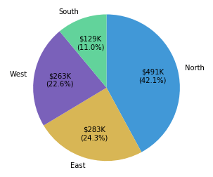

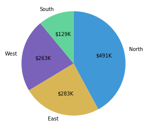

A second type of ‘whole’ is when the total is a sum over an actual data variable. For example, we might be interested not in the number of transactions, but the monetary total from all transactions. Dividing this total by an attribute like user type, age bracket, or location might provide insights as to where the business is most successful.
Basic pie chart: revenue distribution by region
Example of data structure
REGION
TOTAL REVENUE
North
491 064.51
East
283 445.43
South
128 753.87
West
263 391.13

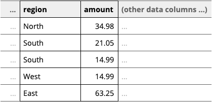

Data for a pie chart can be summarized in a table like the above, where the first column indicates a category, and the second the proportion, frequency, or amount of that category. Usually, the total does not need to be specified separately unless it is to be listed somewhere else on a generated figure. Alternatively, some tools can just work with the unaggregated data as in the below table, essentially performing the aggregation into the table above at time of pie chart creation.
Unaggregated data for pie chart: transactions with region and amount columns

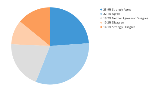

Consider the order of slices
A good order for slices can make it much easier for a reader to understand what the plot is saying. A typical ordering goes from the largest slice to the smallest slice, very useful when there are categories with very similar values. However, if the category levels have an inherent ordering, then plotting slices in that order is usually better.
As for choosing a start point, it’s a good idea to plot slices from a cardinally-oriented direction. Visualization tools will usually start from the right or from the top. While starting from the right has a mathematical basis regarding conventions on measuring angles, starting from the top feels more intuitive, since it matches how we read from top to bottom, and how we think about progression of time on a clock or watch face.
Pie chart with slices sorted from strongly agree to strongly disagree
We do not sort by size here since the labels are meaningful.

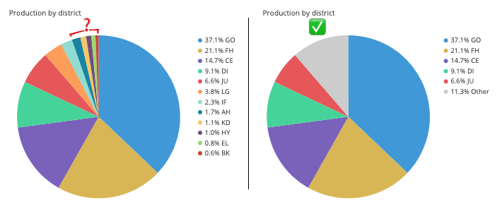

Limit the number of pie slices
Pie charts with a large number of slices can be difficult to read. It can be difficult to see the smallest slices, and it can be difficult to choose enough colors to make all of the slices distinct. Recommendations vary, but if you have more than about five categories, you might want to think about using a different chart type. As another option, you might consider lumping small slices into a single ‘other’ slice, colored in a neutral gray.
Pie chart with lots of small slices, then gathered into a single 'other' category

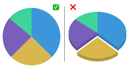

Avoid distorting effects
Reading a pie chart accurately requires that the slices’ areas, arc lengths, and angles all point to an accurate representation of the data. While avoiding 3-d effects is a good idea for any plot, it is especially important for pie charts. Squashing or stretching the circle or adding unnecessary depth can easily distort how large each slice compares to the whole.
Another distortion can come from the ‘exploded’ pie chart, where slices are pulled out from the center for emphasis. This emphasis comes with a cost, where the gaps can make it more difficult to actually gauge the part-to-whole comparison.
Comparison of standard pie chart to a pie chart with 3d effects and exploded slice

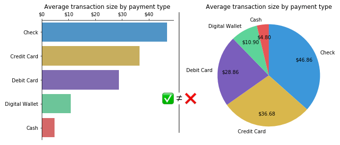

Another tricky case is if the values used for each group are a summary statistic that is not a total. The chart below was built on the average transaction amount for multiple transaction types. However, since it ignores how frequently each transaction type was used, it distorts how much revenue is coming in from each type. While checks have the highest average, they might also be fairly rare in use. In both cases, a bar chart is an appropriate chart type to use.
Improper use of pie chart: sum of averages is not the average of the total

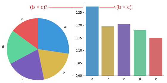

Using pie charts to compare groups to one another
If you want to make comparisons between groups rather than from each group to the whole, then you are better off with a different chart type. Even when sorting slices by size, it can be difficult to tell how different two slices are, especially when they move away from the start / end point. In the below example, you might assume that the second slice is larger than the third due to order, but the corresponding bar chart actually shows the opposite. The main thing that you can really say from the pie chart is that both slices are approximately the same proportions from the whole.
Deceptive pie chart: two slices look similar in size but are not sorted in order of size

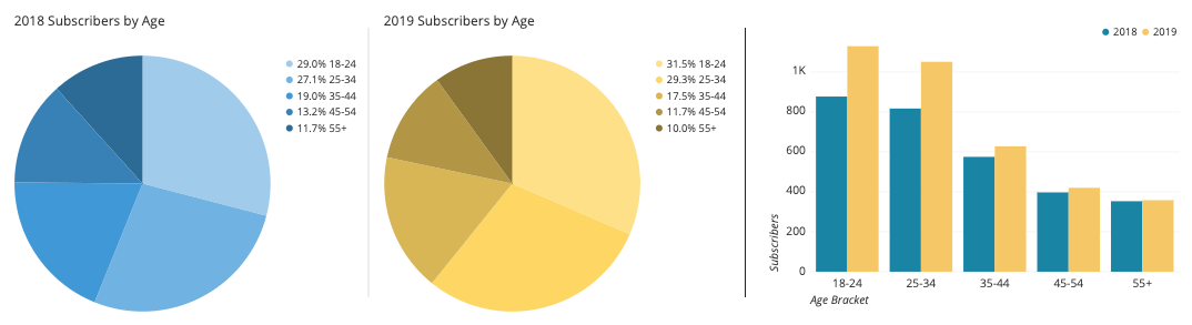

Comparing values across multiple pie charts
There may be cases where you will want to compare multiple pies to one another: for example, comparing user demographic distribution across multiple years. However, this runs into a similar issue as the previous section, where you want to compare groups to one another. Even worse, it’s a comparison between pies, so you can’t rely on the order of slices as easily for the comparison. Expressing the data using a different plot, like stacked bar chart, grouped bar chart, or line chart, is often a better choice when this kind of group-to-group comparison is desired. Like with actual pies, pie charts are best taken one at a time.
Comparing two pies on relative sizes can hide important information about absolute values
Comparison of the pies may imply a shrinking of the older age groups by proportion, but the grouped bar chart demonstrates a growth in the younger groups.

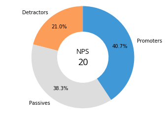

Doughnut plot
A doughnut plot (aka donut plot) is simply a pie chart with a central circle removed. For the most part, there aren’t significant differences in readability between a pie chart and donut chart, so the choice of a doughnut over a standard circle is mostly that of aesthetic. One small boon for the ring shape is that the central area can be used for additional information or to report statistics.
Doughnut plot with summary metric for NPS in central hole

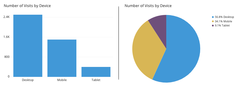

Bar chart
The biggest competition for the pie chart comes from the bar chart. Most of the time, you won’t want to use a pie chart – rather, a bar chart will get across the points more compactly and clearly. Many of the issues with pie charts are solved through the use of a bar chart. However, bar charts do not immediately sell the part-to-whole comparison, which is pie chart’s major benefit.
Side-by-side comparison of frequency bar chart and pie chart

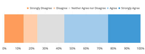

Stacked bar chart
On the other hand, the stacked bar chart type can prove to be a strong rival to the pie chart in its ability to communicate a part-to-whole comparison. A single stacked bar can be thought of as a pie chart’s slices rolled out into a rectangular form. The rectangular form also makes it easier to compare categorical breakdowns across different groups. However, pie charts still have an advantage in familiarity and aesthetics, so they’re still worth having in mind for the part-to-whole comparison use case.
Example stacked bar for responses from strongly disagree to strongly agree

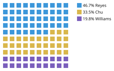

Waffle chart
Another alternative to the pie chart is the waffle chart, also known as a square chart or square pie. A waffle chart comprises 100 icons, typically squares laid out in a 10 x 10 grid. Each icon represents 1% of the data, and the icons are colored based on the categorical distribution of the data. While there will need to be some rounding of category amounts to fit the plot structure – never split icons in this plot – it can be a way of making the relative proportions for each category easier to read.
Example waffle chart depicting proportional vote outcomes
