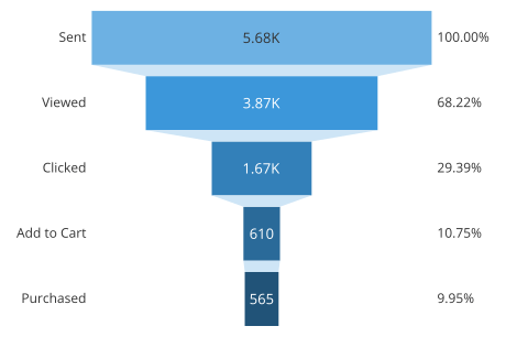

A funnel chart is a specialized chart type that demonstrates the flow of users through a business or sales process. The chart takes its name from its shape, which starts from a broad head and ends in a narrow neck. The number of users at each stage of the process are indicated from the funnel’s width as it narrows.
Funnel chart showing responses to an email campaign
The example funnel chart above depicts responses to a fictional email campaign regarding a special product offer. Each of the five stages of the pipeline are associated with a bar whose length corresponds with the number of users that completed each stage. In addition, listed next to each bar is the proportion of users remaining with respect to the first stage.
From this chart, we can see that the largest absolute gap was between viewing the email and clicking on the promotion link. There was another fair relative dropoff between viewing the linked page, and adding the product to the cart. On the other hand, once the product was in cart, most users then followed through to a purchase.

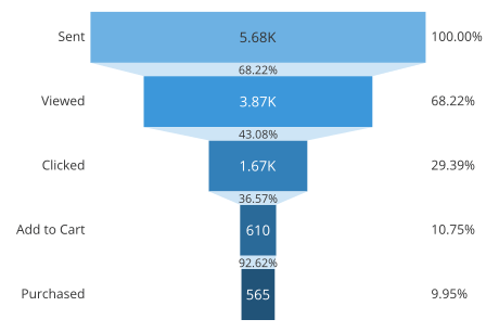

For some visualization tools, you may have the option to show other annotations for each stage. One additional statistic worth tracking is the stage-to-stage proportions. Including this annotation between stages allows for concrete knowledge of drop off rates, without needing to resort to outside computation or estimation.
Funnel chart with stage-to-stage drop offs

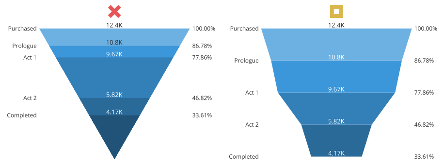

One possible way of generating a funnel chart is as a straightforward triangle. Stages are marked on the triangle where the widths match the proportion of users that make it to each stage. However, this can distort how large or important each stage is.
With the way that the triangle is separated into regions, it can be tempting to associate stage values to areas instead of to the widths of the region boundaries. While the fact that larger drop offs will correspond with larger areas, the actual area will depend on where that drop off occurs. The tapering of the triangle means that losing a certain number of users early in the process will have a much larger area than those lost late in the process. This makes early losses look more important than later ones, which may not actually be the case.
In the example on the left below, the absolute drop off between the first two stages (Purchased-Prologue) is the same as between the last two (Act 2-Completed). However, the area of the first drop off is much larger due to being higher up on the triangle.
Funnel chart with straight edges
Instead, it is preferred to have stages evenly spaced on the vertical axis. What will vary now are the funnel slopes to connect the stage boundaries.

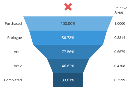

Another common mistake when generating a funnel chart is to add an additional rectangular region to the funnel at the top or bottom, then place the labels in the middle of each region. At first glance, it might seem that areas will accurately match each stage’s value, but this will generally not be true.
The larger the drop off that there is between stages, the more severe the slope will be between region boundaries, and the less area there will be in the corresponding funnel region. The rectangular region will show no drop off, and so be perceived larger than the corresponding stage value should be taken.
In the example below, the second and fifth stages have larger areas than their actual values, while the third and fourth stages have smaller areas than their values.
Funnel chart with unmatched labels and areas

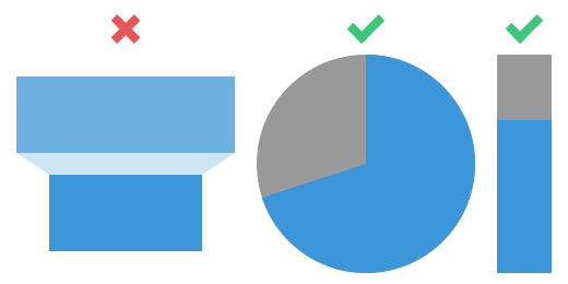

Include at least three stages
In order to use a funnel chart, you should have at least three stages to plot. When there are only two stages in a process, we only have a single ratio to comprehend. A simpler part-to-whole representation like a pie chart or single stacked bar will work better in this case.
Two-stage funnel chart against pie chart and stacked bar

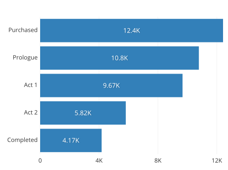

At its core, the funnel chart is really just a fancy-looking bar chart. The funnel chart’s “bars” are aligned to a center line, and connected by additional graphical elements. Meanwhile, a bar chart’s bars are usually aligned to the left or bottom axis (depending on orientation) without additional connecting elements. This common baseline can make it easier to directly compare proportions without needing to look at any annotations.
While the best way to create a funnel chart is to essentially make a center-aligned bar chart, it is often a better idea overall to just use the bar chart instead.
Previous example depicted as a bar chart instead of funnel chart

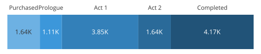

Stacked bar chart
To really sell the part-to-whole breakdown of a funnel process, the most apt chart type is the stacked bar chart. Instead of plotting stage bars in a line like in a standard bar chart, a stacked bar chart overlays all of the bars in the same place. Each region of the stacked bar chart will show the proportion of users that stop at each stage of the process. Make sure that if you use this representation, that it lines up well with how the data will be interpreted.
Previous example depicted as a stacked bar instead of a funnel chart
Note that the order of stages is set such that the process flow can be read from left to right.
One question that might come up is why the uneven spacing of the stacked bar chart is okay here, but it was not okay with the straight triangular form of the funnel. Where the triangular funnel had a different width along its length, a stacked bar has the same width along its length. Because of this, the area corresponding with each user will always be consistent, no matter where in the process they are lost.

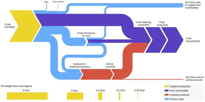

Other flow diagrams like the Sankey diagram can depict more complicated processes than the funnel chart. While a funnel chart expects a simple, linear process, a Sankey diagram can depict multiple sources of input and output. Like a funnel chart, value is encoded in the width of the chart on each segment of the visualization, but those segments may not be regularly spaced out.
Sankey diagram of global harvested crop usage
The above Sankey diagram shows how harvested crops are utilized on a global scale. Source: Losses, inefficiencies and waste in the global food system, Agricultural Systems, via sankey-diagrams.com
